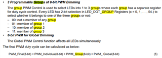

I just want to confirm that the global PWM dimming will work for dots that aren't assigned to a group.
With the formula at the bottom, I assume it just ignores the PWM_Group factor if unassigned?

Hi Michael,
I think your understanding is correct.
