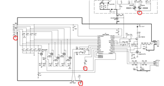

I am using BQ33100 in my design. I referred the datasheet and found there are two grounds used in the reference schematic. Can anyone help in understanding why it is used. Also attaching snippet of the same.

In order to measure current we need to have two separate ground references separated by a sense resistor. The gauge i tied to battery ground, and the system is tied to PACK- which is the system ground. That way we can capture all passed charge.
