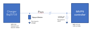

Hello team
Customer want to add 1nF capacitor at PSYS which is close to IMVP9 controller. Is thre any concern?
My concern is inrush current, charging time, over voltage etc.
Best regards
Koyo

Hi Koyo,
The purpose of the capacitor is filtering at PSYS pin. A higher cap would introduce a longer settling time. The typical cap value we use for PSYS pin is 100pF. Although a higher value of capacitor should not be a concern, we have not tested 1nF. What is the purpose of using 1nF on the IMVP9 controller side? to minimize noise due to long wire trace?

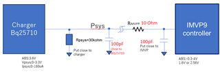

Hi Koyo,
Yes 100pF is safe. But 1nF may affect the stability. An acceptable value would be 10 Ohms. You can use the filter as below. Put the 100pF for the BQ25710 close to the charger. Then use 100pF for the RC filter close to IMVP.

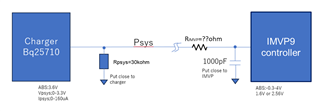

Hi Munir
1000pF is the recommendation from IMVP vender.
How about below block?
Time constant of Rimvp and the cap is same as your recommendation.
Hi Munir
Why is Rimvp required?
If the 1000pF make it possible to be unstable, Rivmp won't help to resolve.
Hi Koyo,
Thanks for asking. The reason for not adding 1nF was that it may result in slow response on PSYS pin voltage. The dominating time constant is still determined by the PSYS pull down resistor and additional 1nF. However, after raising this issue again with design team they feel confident to use 100pF+1nF as well. Therefore, the Rivmp can be removed. We will be allowing 1nF for IMVP in our future checklist given that the customer would like to accept the extra delay due to 1nF cap. The risk of stability issue is very low.
