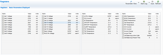

I have attached a screenshot from my bqStudio software for your reference.

    I want to achieve the following: when sending Subcommands(CB_ACTIVE_CELLS, 1 << 8, W2);, the 8th section of the battery should start balancing. By using printf("balanceState = %x\r\n", Battery_Now.balanceState);, the balanceState should maintain at 0x0100 for 60s because I have set BQ769x2_SetRegister(CellBalanceInterval, 0x3C, 1); //60s. However, the current situation is not as expected. Right after executing Subcommands(CB_ACTIVE_CELLS, 1 << 8, W2);, if I immediately read balanceState, it shows 0x0100, but if I wait a while and read it again, the value changes. This is quite confusing to me.

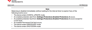

    The CB_ACTIVE_CELLS command will initiate the balancing, and the command might take up-to 1 second to execute, as you balancing delay timer will determine how long to balance for. My suggestion will be to use the 0x0085 CBSTATUS1() in combination with the 0x0083 CB_ACTIVE_CELLS() reads to determine if balancing is active and how long has been active for. Also, refer to the status registers to see if a fault on your system terminated balancing earlier than expected, you can read more on cell balancing on the Technical Reference Manual (https://www.ti.com/lit/ug/sluuby2b/sluuby2b.pdf) Section 10.1 Cell Balancing Operation, about what can stop cell balancing.
