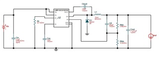

It seems odd that the algorithm to buck +48v down to +24v produced odd component values. Such as the schematic output capacitor is very low (100nF) and 3mΩ FB circuit and BOM used huge 0603 resistors that are not in the NFET switching path, why? The choices that came up for low parts count selection and wide input voltage range for web page to ever show LMR16030 required buck 54v MAX 24v/3A, some selections had over 27 passives though less than 4 is more typical of other bucks, Web bench shows 11 piece BOM. Reference datasheet (SNVSAH9B – DECEMBER 2015 – REVISED MARCH 2021)
The battery input range +36v - +56v absolute max. Desiging for 48v LiFePo or SLA battery to float 52v max ever rebalancing discussed some forums some batteries refuse to charge though many cycles being left. The actual host PCB current is <1A powered by linear 24v DC supply LM317. The PCB sports 3 Rohm bucks absolute 45v input, hence the reason to update design to handle 48v variable input range. Could you please point me to any other bucks that have fewer passives perhaps specifically designed to handle variable +48v battery source? Why does the schematic for Tina export have only 100nF to hold down switching ripple? The 3 bucks (+5,+12,+15v)  have 22µF ceramic each and one or several distant 22µF bulk electrolytics near current source points. The 3 bucks switch 1.5MHz in 20-40KHZ PWM inductive drive system. Each buck has 9-piece BOM with one EN detect threshold circuit for +5v, +15v, hence SS feature LMR was chosen. The current inductors are 10µH keeping BOM light so LMR 22µH with 1nF output filter seems way off even for 500KHz switching.

    The device you selected is a non-synchronous converter that requires an external diode; so that is one extra component.
    The output voltage is 24V, so you need feedback dividers and a Cff.
    The device has adjustable switching frequency, so you need an extra resistor to set the frequency.
    I am not sure why you are getting strange values from Webench.
    I have attached a design using the LMR16030 from Webench.  The values seem reasonable to me.
    I have also attached a design using the LMR36510 that requires fewer components.
    Of course, TI has other 60V devices that may also meet your needs.
    I hope this helps.

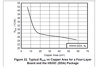

    You can use the graph below to estimate the required copper area required
    for a given thetaJA; it is only approximate.  We usually specify 4-layers, 2oz on outside and 1oz on inside.
  • Hi Frank,
    What graph below?
    It's two-sided 2oz PCB with digital GND top/bottom, isolation high voltage ground via 0R copper zones. Multilayer PCB often have future via issues can't withstand high surface temperatures even 2oz warpage is sure to occur. Notice many TI 4-layer launch pads have some amount of warpage, hence my fear and added cost choose to use other counter measures. Such as via placement joining top to bottom around zone flood fills component thermals to ground, KiCad has amazing zone priority control.

    Here is the graph.
  • I really do not get how 4-layer PCB has anything to do with HSOIC package as thermal pad and vias should be isolated from any middle layers. Surely the above graph is not Cm^2 that would be huge square inches most any PCB would not have that kind of free space. Note Fig.10-1 shows small copper space for the thermal pad, not much more. For example, 30cm equals 11.8" of copper. Seemingly 30mm^2 equals 1.81" copper a bit more believable.

    The thermal vias must be connected to all ground layers under the device to provide
    the most effective heat sinking.  Although the inner layers are not as effective as the outer layers,
    they do provide some heat sinking.

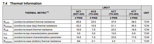

    That Fig.22 above you never answered my question about centimeters versus millimeters. The total Pd is only 3.2 watts +24v 2.5A linear output current not average current. Yet LMR drive feeds 3 downstream bucks sourcing average current drawn via 85µF output reservoir capacitors. Even if required minimum 10Cm^2 copper that would be a huge area for Pd of only 3.2 Watts. It's not like heat pad is dissipating even 10 watts. Given the graph curve hypothetical for theta resistance pad to foil 34°C/W the NFET junction would be near 109°C. So 10cm^sq (10x10=100cm foil area) 39.37" of foil for 3.2 watts, really? Seems the graph is for some other device not LMR has absolute MAX 150°C. LMR can't be 94% efficient and generate that kind of junction heat, wasted energy!
    LMR datasheet shows RθJB Junction-to-board thermal resistance 25.5 °C/W through metal pad to copper PCB area. That is excessively high thermal resistance to heat transfer, e.g. NFET substrate + epoxy + metal pad to PCB copper. For example we use a silicon heat pad rated 16W/°C resistance on TO220 NFETS that can run at 175°C. So I have hard time believing 45cm^2 foil required at 25.5°C/W thermal resistance heat transfer.
    RθJC(bot) Junction-to-case (bottom) thermal resistance 3.8 °C/W is more likely the thermal pad resistance, not the case.

  • Some of the issue is the Tja and RθJC(bot) data sheets package design assume 2D space, top view is front, bottom is back in 3D CAD space. Looking at LM317KCS package is 2D model for 3D part being very confusing. So TO220 does not mount bottom tab to PCB and top = front and bottom = back. Need to note 2D or 3D CAD space describing SMT thermal pad and vertical placed components are 3D, not 2D CAD view, accept footprints. Always package legs being very high thermal resistance when it comes to bottom metal plate epoxy substrates carry the main Tja to copper foil or ambient air.
    LM317KCS:
    RθJC(top) Junction-to-case (2D top) thermal resistance 43.2 (3D Front) 15.9°C/W
    RθJC(bot) Junction-to-case (2D bottom) thermal resistance (3D back) NA 0.1 °C/W
    WB_LMR16030S_OperatingValues_760KHz.csv
    So 94% LMR buck efficiency the input drop 48v to 24v produces very little IR for 2.5A load, Pd = 3.2 watts. Perhaps the decimal point is in the wrong place RθJB Junction-to-board thermal resistance? That is terrible thermal resistance for device rated 3A claims high 90% efficiency.
  • Hello Genatco,
    LM317KCS has different package like SOT 223 and TO220.
    You can see for SOT223, the RθJB has reached to 16.8°C/W as well.
    So I think it is normal to have RθJB=25.5 °C/W for LMR16030 because of bigger package size (SOIC 23-6).
    You can refer  more to below link: https://www.ti.com/lit/an/spra953c/spra953c.pdf?ts=1708306922270

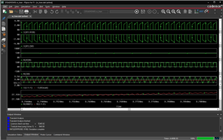

    Also discovered LMR16030sdda_trans.olb Cadence model with wattage probe placed inside Spice block does produce a thermal graph. Oddly the pulse peaks seem to push upward 100 watts for <3A load. The input and load currents plot as negative graph values and much greater than 3.35 watts listed in Webench CSV file.
  • Hi Sir,
    I am not sure this model can test power directly.
    I see Vout can be 30V and Ioad<3A,so the peak power can be 100 watts.
    Colin
  • If the device package is also dissipating Tja (42°C) the peaks can never reach 100 watts. The analysis seems wrong sustained peaks of 100 watts would eventually burn the FR4 PCB even in direct contact with copper foil. One purpose to run Pspice simulation is also to determine how much foil is required to dissipate peak wattage from Tja peak.

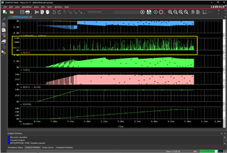

    Oddly the current and watt probes cannot be added to a plotted graphs though present in the macro when simulation probes are removed. Similar probes added to Tina LMC317KCS circuit has excellent DC analysis of input to output power. Oddly same probes placed on Tina LMR macro produce no DC analysis input or output load.
    Cadence steady state LMR16030 is not producing peak power in 350µs. Actually takes 4.5ms to see the peak voltage, current and wattage is not a selection in the output graph trace properties when adding graphs. I copied the modified passives values schematic from transient into steady state analysis and updated the netlist, remained the same in both simulations there was no change in the cache.
    Remain puzzled as to what is happening though steady state plots do produce 4 graphs. Also removing SS pin capacitor from the schematic did not seem to matter and LMR macro SS = 1 still requires 4.5ms to reach full voltage current load.
