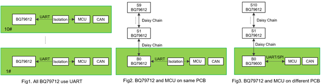

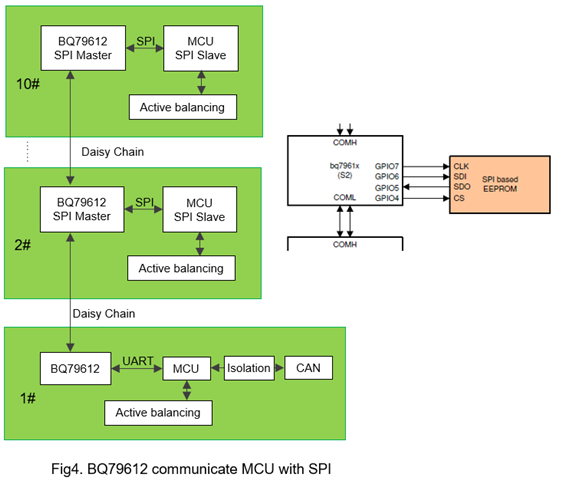

Looking to get answers to a few questions:
For reference project details are;
Stack application where each module is 12S
Up to 10 modules stacked.
Using BQ79612
In almost all diagrams I see that the only the base device has an MCU connected to it.
Let's say I want an MCU on all modules in the stack where each MCU connects to the RX/TX pins to the corresponding module's BQ chip.
Can each module's MCU then read individual cell voltages local to that module and trigger an active balancing circuit?
I think this should be possible but I didn't see anything about stack devices also having MCUs connected to them in the datasheet.
