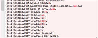

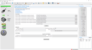

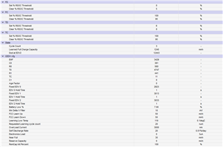

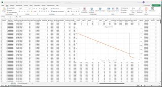

we have a 14S4P battery pack where we have a SOC jump at the end of each cycle. Once at 17%, then 13%, then 10% etc. but it will always jump and not go continuously down to zero. Furthermore we also miss around 1Ah of capacity since it should have 13.4mAh (3.350 per cell) but we have 12.4mAh after 16 cycles.
So I am assuming there are some problems with the CEDV but we are in a bit of a hurry so I wanted to ask if there is any possibility to go around that by fixing some of the gauging parameters.
