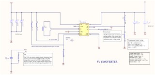

I am reaching out to seek your expertise in addressing a concern related to the assembled boards for which I have attached the schematic, layout, and 3D view snapshots.
I have identified that all of the boards are emitting higher pitch noise. Some of them are higher than the other. Notably, this noise only starts to emits when a load is connected despite it's rating. Furthermore, I have observed that the issue intensifies when the input voltage is lower than the output voltage, particularly during boost mode operation.
Your insightful feedback on this matter would be highly appreciated. I am confident that your expertise will provide valuable insights into the root cause of these noise issues and guide towards effective solutions.

  • Hi  Daniel,
    Thanks for reaching out, what kind of load? pulsed one with audible frequency?
    Another kind reminder, it is not good to connect Pad and vias by thin trace, you can just pour over to decrease the parasitic inductor.

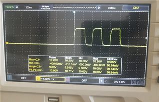

  • Hi Tao,
    I am going to insert some waveform I have taken from VOUT, INDUCTOR, AUX, and FB pins.
    DC Analysis
    OUTPUT
    INDUCTOR (Left Side)
    INDUCTOR (Right)
    AUX
    AC Analysis
    OUT
    AUX
    IND
    FB
    By looking at the waveform, what do you think? Do you have any suggestions and tips for improvement?
    Thank you!
    Daniel

  • Hi  Daniel,
    Sorry for delay.
    According your figure of output in AC analysis, device work in PFM mode and the switching frequency is close to audable one.
    FPWM mode is acceptable? if so, could you help try with R12 mounted with a zero ohm resister? Anyway, it is worth to replace R12 with a zero ohm resister to find out the audable noise is caused by PFM or not.
    Tao

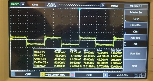

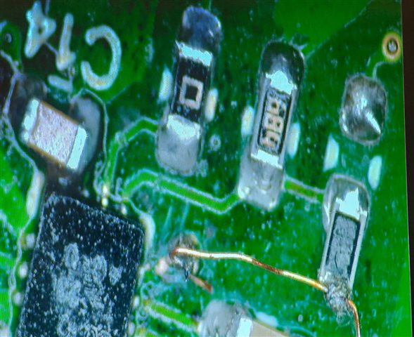

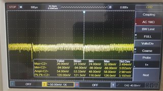

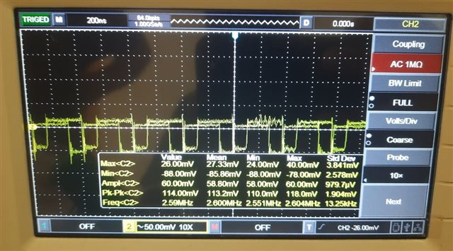

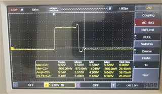

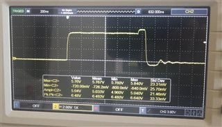

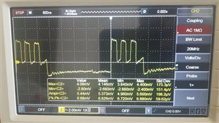

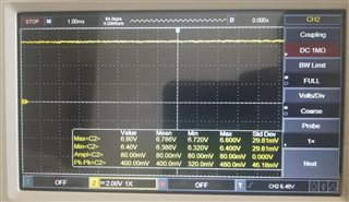

  • Hello Tao,
    I've already did that. The good thing, the noise got minimized comparatively, however it still very much exists. And the noise seems to amplify at a range of 6.9 - 7.0V when it's the loudest. Even someone from a few feet away can hear the sound. I'm going to attach few snapshots of the output and inductor here,
    OUTPUT (BUCK/BOOST)
    1.
    2.
    3.
    Inductor
    1.
    Peak Noise at ~7V (Readings)
    OUT (Doesn't seem stable at all):
    1.
    Inductor
    2.
    Moreover, I've tried to connect the FB Ground node to the control ground with a jumper, that didn't help either. The noise remained as it was.
    1.
    At this stage what would be the right thing to do and what seems to be the reasons behind it? Moreover, how do we get a noise-free and audible high pitch free output?
    Thank you!
    Daniel

  • Hello Daniel,
    This week, the expert is out of the office. Please await his answer then.
    In the meantime, you might check if the noise is gone when you exchange the ceramic capacitors by either physically smaller ones or some of them by some electrolytic one for test purposes only. Ceramic capacitors especially in the bigger packages are known for creating audible noise.
    Brigitte
  • Hi  Daniel,
    Please help to capture the waveform of switching node in one snapshot, then we can check if there is a mode transition during work. please set the oscilloscope at 100us/div or higher.
    How about this item, could you helo to capture waveform of both switching node in one snapshot? how many channels in your oscilloscope, one only?
    Also, it is better your can help to capture output voltage, set-up of oscilloscope. 20ms/div in horizontal.  DC value with offset. 100mV/div in vertical.
    Reagrds
    Tao
