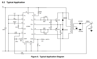

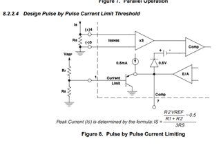

We are using the UC2846DWTR current mode controller, but I am not understand how the current limit circuit works.
For example in this circuit, R2 = 1K R1 = 1.5K and Rs = 0.5ohms. Ilimit = ((5.1V*1K)/(1k+1.5K) - 0.5)/(3*0.5)=1A. Will the controller limit the input current of the push-pull converter up to 1A?
Also, how do I check if the limit current circuit is working? Because we are testing our product above the current limit and it is not activating the protection and it is damaging our modules.
