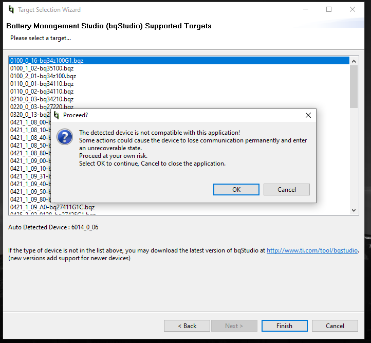

  • feedback customer:
    thank you for the information. I have already installed 1.3.124 TEST but get an warning message at the beginning:
    So I thought it is a good idea to downgrade to the newest STABLE version “1.3.111.1” ….But it is not possible to load this from any TI web page.
    But it is looking like that all other things are working fine (e.g access to the by34z100eval register) - therefore I think I can live with it.
    By the way: I choose to start with the bq34z100 because it supports a lot of cell chemistries and because it is used in a current NiMH battery pack. I will check the BQ40Z50-R2 as well because LiIon is the most promising chemistry type so fare.

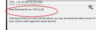

    The error you are getting is not related to the tool but rather to the target file that is missing. The tool autodetected a FW, see the red below. This is what you are missing.
    I suggest you forcedly open the first bqz file shown and navigate to the programming tab and program the latest FW in ti.com.
    https://www.ti.com/tool/download/BQ34Z100-DEVICE-FW
    Jose Couso
  • Customer feedback:
    Ok, this explains the warning massage. I could update to the latest FW “0100_2_02” with the link you provided.
    Unfortunately bq-Studio doesn’t support this either. Probably it is too new. In the bq-Studio selection list is only “0100_02_01” stated… Don’t worry. This should work for me and probably with the next release of bq-Studio the latest firmware for bq34z100 is listed.
  • Hi Frank,
    Once you download the bq34z100_v2_02_00_31.exe file and install it. The target file "0100_2_02" will be listed in "C:\ti\bq34z100_v2_02_00_31".
    Once you are in the above folder, please copy "0100_2_02-bq34z100.bqz" and paste it here: "C:\ti\BatteryManagementStudio\config"
    The BQZ file is the target file that corresponds to the FW (srec file).
