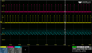

I'm working on a flyback design using a legacy part, UC1825BJ/883B, and I've encountered some technical concerns that I hope you could shed some light on.
The issue I'm facing is that OUTPUTA and OUTPUTB often miss a cycle under the same load conditions. OUTPUT_A is tied to the gate of a MOSFET, while OUTPUT_B is left open. I've already verified that ILIM stays below the Current Limit/OverCurrent threshold.
Channel#1: OUTA | Channel#2: OUTB |Channel#3: CLK

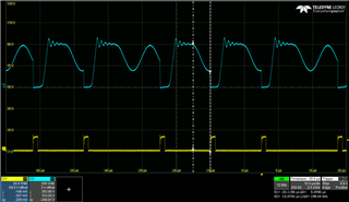

CH1: OUTA, CH3: V_DS on the MOSFET
Wondering if you have any suggestion where I should look into regarding this cycle skipping issue/feature. Which portion of the part/circuit might control this valley detection/ Somewhat Zero Voltage Switching on VDS?

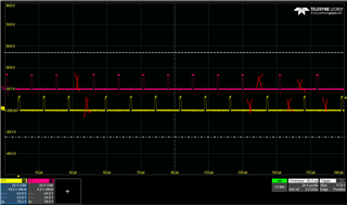

  • Hi Hong,
    I finally got a chance to remove the C11. OUTA and OUTB pulses still skip here and there just like before (see the capture below CH1: OUTA, and CH2: OUTB). Wonder if you have any suggestions.

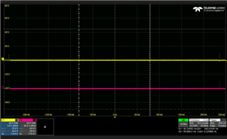

  • Hi Huang,
    Please bare with me on the slow response.
    Removing C8 didn't help at all. It actually breaks the circuit. You can see the waveform as below: CH1 is OUTA, and CH2 is OUTB. It no longer functions normally as PWM output. The frequency drops to 6Hz for both OUTA and OUTB.

    If remove C8 actually causes some malfunction, it is likely your current sensing signal has too much spikes which charge up C8 when it is there then causing pulse skipping. You can measure the ILIM pin and RAMP pin to find out. The pulse skipping is usually due to the current signal exceeding threshold so you also measure pin 3 to see if it exceeds 1.5V to cause pulse termination very early (no pulse).
    Please follow the diagram on datasheet page 1 to find which signal to cause the pulse terminate too early. This is basically the basis to make debugging.
  • Hi Hong,
    I appreciate your input. Removing C8 would make the circuit malfunction due to the fault condition. Your explanation and the datasheet indicate that info clearly. In this case, C8 serves as a filter, without the filter, the overshoot would come in and trigger the fault condition as expected.
    However, it doesn't explain why there's a skipping cycle while C8 is there. This skipping cycle is random. This skipping issue most likely doesn't relate to the Fault Condition due to its randomness and high frequency. Notice that the PWM waveform under fault condition should have a significant low frequency, in the Hz range, which is not true in my case.

    C8 might have voltage residual randomly charged by the current spikes so when C8 voltage becomes high enough then terminate the pulse so cause pulse skipping. The spikes are possible randomly showing so the pulse skipping randomly. Similar to RAMP  and COMP. It looks to me it is likely due to your board layout or transformer leakages which causing too much noise.
    You can capture these pins waveforms to find out and if you do see the noise you need to reduce the spikes or otherwise you would have to tolerate the pulse skipping.
