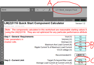

What is the error range for the current limit from "Average Load Current at Current Limit (A)" in Step 2 of the "Quick Start Component Calculator"?
For example, maybe ±1%? Also, where can I look in the data sheet to determine this?
Is it possible to set it to 0.1A or something like that?

    'Average Load Current at Current Limit' is just a simple calculation based on your inputs.
    A=(1+C)xB = (1+0.25)*15 = 18.75A
    -EL
  • I would like to know how accurate "Average Load Current at Current Limit(A)" is.
    I would like to know what the range of error (± what percentage) is and how to determine it from the data sheet.
    Or, if "Average Load Current at Current Limit (A)" is different, could you please tell me where to look for the current value when current limit is applied and the error range at that time?
  • Hello nnn
    As I mentioned, "Average Load Current at Current Limit(A)" is just the multiplication of 'Maximum Ave Load Current(A)' and 'Target(%)'. The 'Maximum Ave Load Current(A)' and The 'Target(%)' are both user inputs. Therefore, there shouldn't be any error.
     Peak current limit level is calculated by EQ (5) . The tolerance of CRAMP, RS is decided by users. tON is a function of VIN ,VOUT and FSW
    And the tolerance of 1.1V / A  is mentioned in the EC table
    -EL
  • When calculated using formula 5 (peak current) (the formula on the right) of the data sheet,
    It is "Short Circuit Current" in Step 2 of "Quick Start Component Calculator". Is it correct that the current is limited to this value?
    In that case, is "Average Load Current at Current Limit(A)" displayed as a reference value that can flow this value?
    Also, how should I calculate "ton" in equation 5?
  • Hello nnn
    In buck converters, ton = VOUT/VIN/Fsw  if no loss.
    When the VOUT is grounded, the output current will be limited to 'Short Circuit Current'
