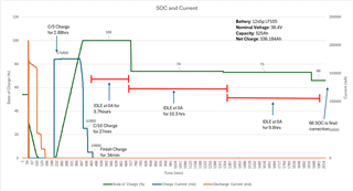

BQ34Z100-G1: SOC/Remaining Capacity drops after Idle
Part Number: BQ34Z100-G1
Other Parts Discussed in Thread: EV2400, BQSTUDIO
BQ FW Version: 0100_0_16
Battery: 12s5p LF105
BQ Configuration: Golden Image was created on 12s1p and has been scaled to work with 12s5p battery.
After a complete battery cycle the SOC dropped from 100% -->74% -->73% -->66%. Battery received ~536Ah.
The SOC corrections all took place when the battery was left in Idle at 0A.
After reviewing the gg.csv pulled from the battery, cycle count never updated to 1.
What would be causing this to happen?
 FBP-1328 24010154 BAD DFI -- Drop from 100 to 66 after resting.gg.csv
