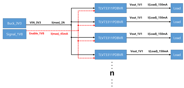

Dear Team,
Hi, i'm developing applications with TLV73311PDBVR LDO.
Please refer to the picture below.
1) To operate TLV73311PDBVR, apply power to VIN_3V3 and VEN_1V8.
2) LDO output 1V1 is connected to Load. (max Load Current: 150mA)
3) As shown in the picture below, the VIN_3V3 and Enable_1V8 Lines are one line each, and we want to use them by connecting at least 4 LDOs.
In the case of Buck_3V3, the maximum output current is 2A, so there seems to be no problem.
I think, The problem is that the maximum output Currnet of Signal_1V8 is about 45mA.
If I want to obtain stable output under the current conditions, I am wondering how many TLV73311PDBVR LDOs can be connected. (Like Fan-Out)
Is there a way to calculate it? I would like to know more about the conditions to consider.
