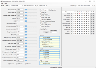

I just tried to connect the evaluation board BQ24195EVM-193 to PC via USB-TO-GPIO2 interface adapter.
When I have connected the interface adapter to PC, it was detected as USB2GPIO v2.0 USB device and the green LED on the adapter shines. After that, I connected the adapter to the evaluation board, connected +5V power source to J1 of the evaluation board, downloaded an evaluation software BQ2419xEVM - GUI v1.5.0.1 from dr-download.ti.com/.../sluc391a.zip and then launched the software. At the bottom of the screen, there is a message "No USB Bridge Attached" and nothing more happens. When I try to read or write, there is nothing on SCL and SDA but 3.3V. It seems that the software is incompatible with the adapter. I tried to do it with 3 different PCs with Windows 10 and also with compatibility mode but the result was the same.
What could be the reason of the problem? Perhaps some another software and/or device driver is required?
