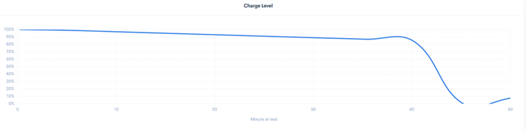

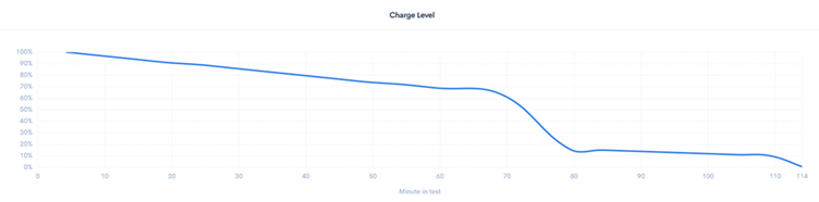

  • Hi Evan,
    We have hundreds of units under test before being sent out, so I can't possibly log all of them.  I raised another ticket (which you replied to) about units reporting 0% charge when they are fully charged.  Here is a selection of oddballs from today's tests (recorded by our own system, not BQStudio).  After disconnecting and reconnecting the battery, these unit tests correctly.

  • Hi Adrian,
    You will not get accurate SOC with a ChemID match with 13.72% DOD% error. In order to achieve accurate gauging, the DOD% error need to be 3% or less.
    You can do 2 things to fix this...
    1) try to redo your GPCCHEM charge/discharge cycle and see if a better ChemID match is obtained due to an error during the initial time using the tool.
    or
    2) you can get aa custom chemID made for your battery cell. Please reach out to your supporting FAE or local TI office to get this done. This will take about a month, to be completed.
