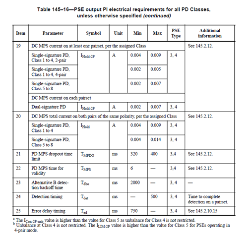

Hi expert,
May we know if you have experience on Sifos PDA600 PHY min Port test? My customer would like to know how to design the value, is it 50V? They are testing Sifos MPSViolation_4 and found out current is lower than 16mA. Other vendor(ADI) recommend they to use 802.3bt clause 145 definition on Vport_pse-2p to set it. But their IEEE team would like to follow 43.5V to set it. So they would like to know our recommendation for it, and the reason. Thanks a lot!
