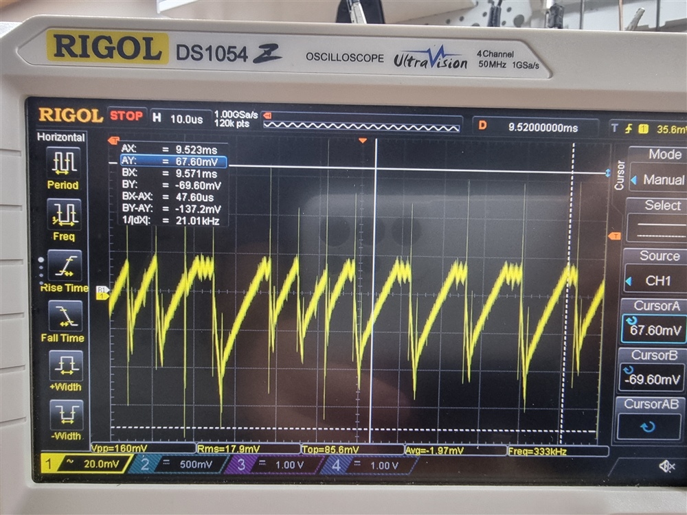

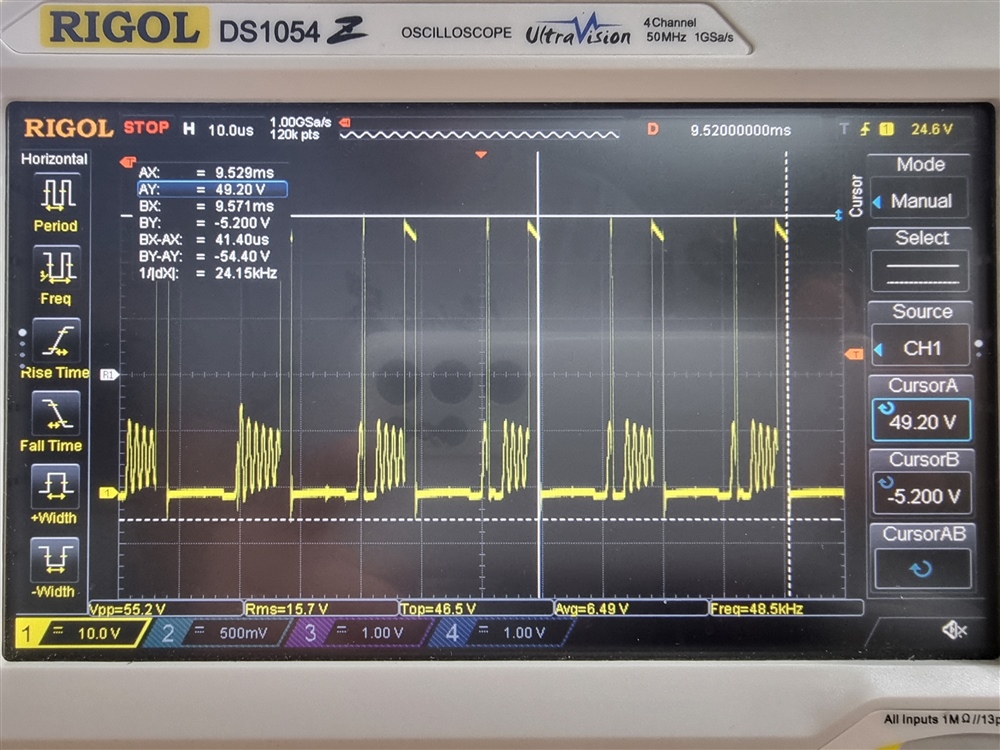

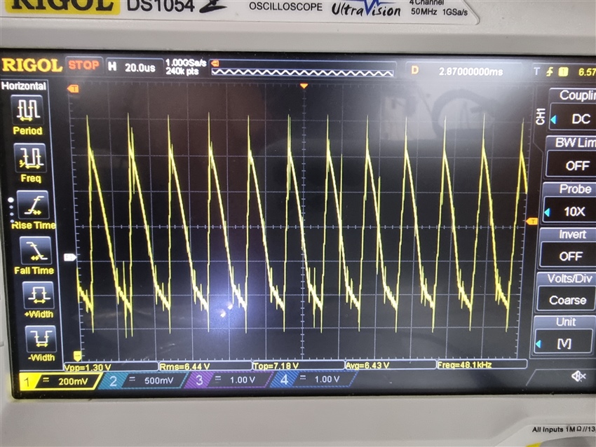

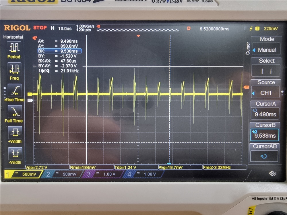

I have a board based around the LM5116 Switching controller, to take 32-60V in and put out an adjustable 5-30V with a max current of 20A.
Although the board does work, I get over 1Vpp noise on the output even with the output capacitors shown. I am currently using a 4.5uH inductor for testing as this is what I have on hand, but I need to figure out the noise issue before I go and spend the money on more components for the board.
