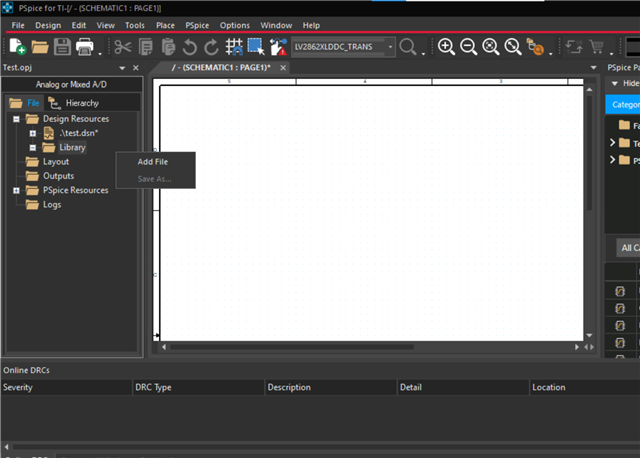

I cant find the LV2862 in the library, so is there a way to import the PSpice model found on the component webpage into PSpice for TI?

Step 1:
Open your project and right click the "library" folder as shown below
Step 2:
Click "Add file" and navigate to the LV2862 olb file that you got from the TI.com for the LV2862X. Click "Open."

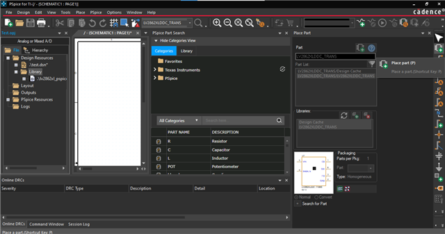

Step 3:
Next click the place part icon on the right hand tool bar as shown below. This should open up the library files of your project
Step 4:

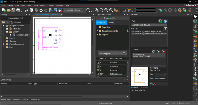

Click on the white space in your schematic. Then navigate to the LM2862 model that you want located on the right hand side and double click. You should be able to place it on your schematic.
It should work from here.
