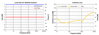

I downloaded TPSF12C1-Q1 design excel tool. When I change some parameters the graphs are destroyed, and even if I turned the default values they were not fixed. How can I solve this problem?

    I am using the latest version _A9. As far as I observed most of the parameters will create this issue. For example, if you change the system type from three phase to single phase It will turn off the plots above. One more example, for example Cd1 is given 8.2 nF default. If you change this value to 8nF, with very small change, the graphs also destroyed.

    When I toggle parameters I realized something. If you toggle Step 2 parameters the graphs was fixed. But at the end the first selection was selected. I think there is a bug in the excel. You can refer the same excel on the website with A9 subscript.
