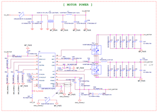

Hi, TI support team
Please review below circuit.
Thanks.
MJ
MJ,
Please fill out and attach a quickstart calculator.
https://www.ti.com/tool/LM5146DESIGN-CALC
Be sure to tie SYNCIN to VCC or GND to configure FPWM or Diode emulation.
Hope this helps,
-Orlando
