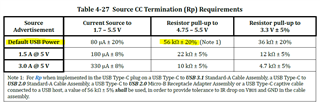

Hi team,
Set ADCIN1~4=(0,1,1,5).
The SINK side requires at least 7.5W (5V/1.5A), but the built-in PPHV SW turns ON even if the source side can supply only 2.5W (5V/0.5A).
The CAP_MIS signal toggles H/L to indicate a mismatch, but PPHV always outputs 5V.
Is this a TPS25730 specification?
Also, is it possible to know what power supply is connected?
