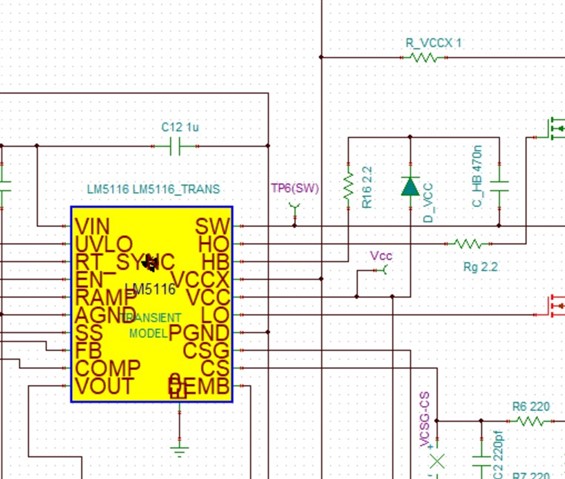

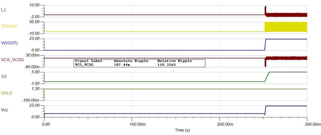

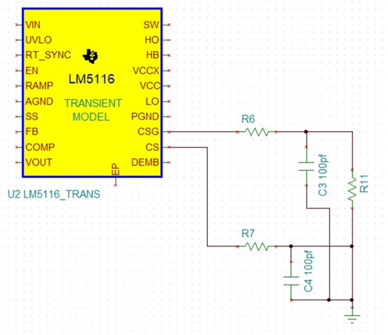

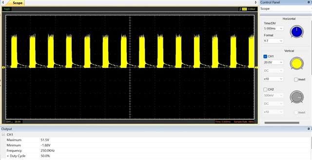

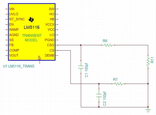

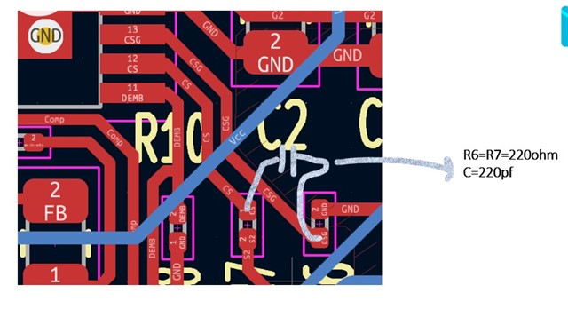

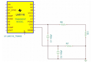

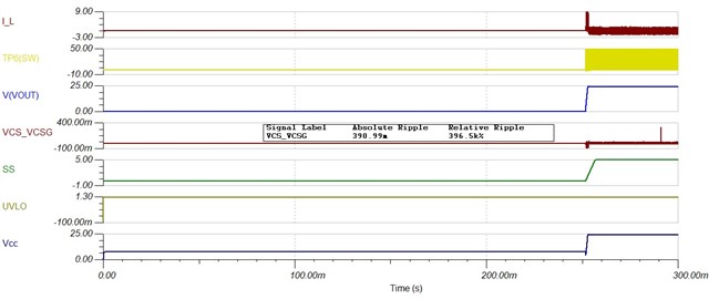

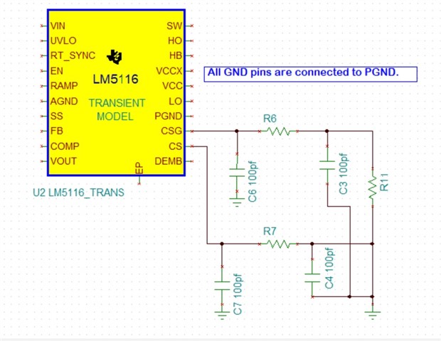

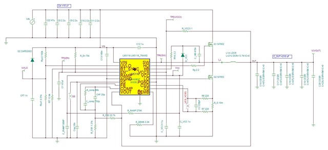

I back again but in the next step, I am testing a prototype.
When I apply 48VDC at the input without load, it only gives me 10VDC at the output while I tried to design it up to reach 24VDC in the output.
I measured the Q1 drain voltage which is 48 volts like in input. Also, I measured the Q1 source voltage that is equal to SW.
I don't know how can I see my inductor is working correct or not?
I have attached the images of all my test points.
Thank you so much for helping me in different steps.
Leila
