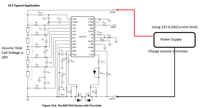

Attach herewith word file with the question. Thanks in advanced.

Hi Po,
How are you disconnecting the cells and reinstalling them?
It may be that while reinstalling the battery a transient is causing a cell to trigger an OV fault, and the cell's actual voltage is above the recovery threshold.

Hi Maxwell Verboncoeur,
I connect with banana plug for testing purpose. I think I found the issue, thanks.
