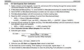

I have question about current calibration.
I do according to the above document, but the calculation of the CC_GAIN is wrong.
Are there any restrictions on the Icc ?

Hello Arkadi,
Can you please elaborate on why the CC_gain calculation is wrong?
Icc is limited by the sense resistor. Imax = VCC / Rsense. Where max Vcc is +/- 200mV
