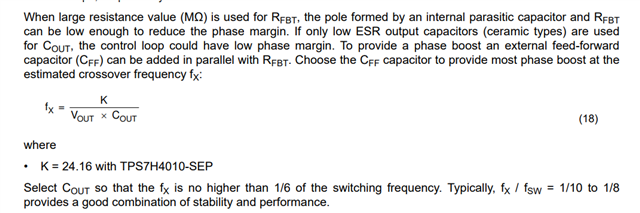

Section 7.3.10 of the current datasheet describes how to calculate Cff - esp eqn (21)
When we apply that calculation to the EVM design (Figure 4-2, copied below), 12V -> 3.3V, 6A, ~150uF ceramic output cap & 100K/43.2K feedback divider, I get ~ 9nF for Cff.
The EVM design shows 22pF. Why the big discrepancy? Would you please check my calculation to see if I made a mistake somewhere?
What formula should be used to calculate Cff?
