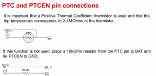

Currently i am using BQ40Z50 design one BMS, about PTC thermistor, do TI have any recommended PTC temperature sensors?
another question, about LEDs, in my project i do not use this function, i let the DISP pin connect to Vss, and LEDCNTL pin direclty connect Vss not added 20K value resistor, what kind of consequences will occur?
