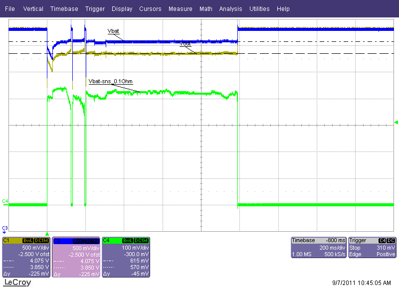

    Every power IC on the market has a wide range of operation based on how good the cooling is and all manufactures set peak proformance with optimal conditions and the designer has to derate the part based on how it will be used.  Do you have the EVM?
    I did a test on one EVM I had and it put out 4.2A for 1 second, see plot.  My 1W resistor started smoking so I had to discontinue the load, but at that time the short circuit protection had not kicked in.  The drop from the BAT connector to the OUT connector was 225mV and it was probably closer to 210mV at the chip so I believe that the current could go 20% higher.
