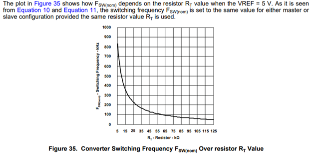

    4. If I connect RT pin to GND via 47k Resistor, will my Oscillator frequency be 126kHz?
    Santhosh> The image you attached shows the relation between RT and Switching frequency not the oscillator frequency.
    >I read the data sheet and you are correct.  The internal oscillator is 2 X.

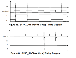

    5. What will be the frequency of the output pulses OUTA, OUTB, OUTC and OUTD? Is it equal to Switching frequency or Oscillator frequency?
    >I believe it is the same.
    Santhosh> Can you please elaborate your answer. you mean frequency of the output pulses is same as the switching frequency and also oscillator frequency?
    >After reviewing the data sheet the switching frequency is for one output which is half the internal oscillators.  I found these figures in the data sheet for a visual representation.
