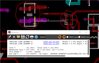

    I checked the signal at r3 or r4, and there is no signal waveforms for pulse widths below 6ns.
    The VDD bypass capacitor is on the left. The distance from cap to lmg1020 is about 151mil.

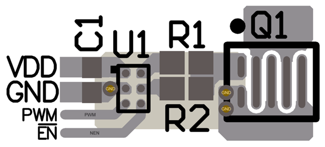

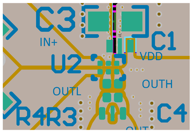

  • Hi li,
    Because the LMG1020 is a very fast driver, it is critical that the bypass capacitor is very close to the device. Here is an example layout from the datasheet, where the first one is just using a decoupling cap, and the second is using both the decoupling cap and feed-through (similar to your schematic):
    You also mentioned that you used our LMG1020 EVM. Did you make any changes to the board before using it to test it with 2.5V IN and 3ns width?
