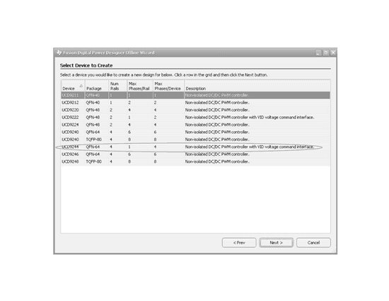

Hi all,
I just downloaded the Fusion Digital Power software so I can config the UCD9244; but I coundn't find the device on the device list.  any one have any idea?
Bonzai
  • In the offline version of the Fusion Digital Power Designer, select Create New Design/Project and click Next.  On the next page choose UCD92xxFusion Digital Power Controllers and click Next.  The following window should be displayed which includes the UCD9244.
