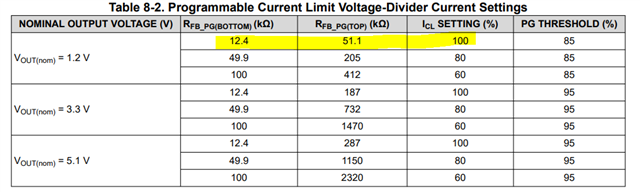

Hi team,
Let me confirm about the resistor divider divider on the Table 8-2.
To what extent can this resistance variation be tolerated? However we can find 1% resistance use case, that is sometimes difficult to make the value with E24 parts without reluxing..
Thanks in advance.
