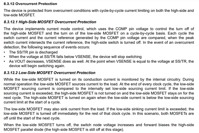

I have two questions for the
Are there any plots or graphs that shows the behavior of the TPS50601A-SP?
1. Im trying to figure out the short circuit capability and how it would behave. It looks like there is a high side and low side current sensing in the device so it would sense a short circuit event but will it restart or would it shut off and retry?
2. What is the turn off delay when the enable signal goes low? I can only find the turn on delay but not the when it goes low?
