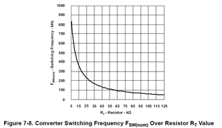

I'm goig to test the UCC28951 on a PSFB already driven by UCC2895.
I want to evaluate the UCC28951 designing an adapter PCB in order to replace the UCC2895.
I have some doubts:
the Fsw must be 25kHz, so is it enough to set Rt at 247K or there are there are any problems?
I need a fixed DELAB(CD) son can I set Ra=0R and do not populate Rahi?
