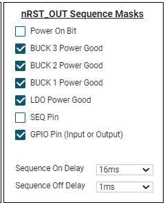

if my customer would like to use nRSTOUT to control the sensor for reset.
Based on the GUI i can find the function as below picture. But which address control nRSTOUT? Is it 0x0011[3E]?

Hi Jimmy,
You're correct, these check boxes are writing to register address 0x11, SEQ_TRIG_nRSTOUT.
The on/off delay settings are writing to register address 0x17, nRSTOUT_SEQ_DLY.
