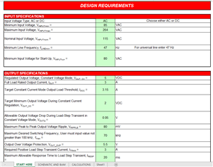

    -I took a look of your FET and STP3N150 is a 1500V, 2.5A, 6ohms with a total gate charge of 29.3nC. Why do you need a FET with such a high VDS voltage and gate charge? The big gate charge of your FET is not letting the gate driver of the IC to turn it on completely. This is reflected in your 5V pulses (it should be 10V or higher), the gate to source capacitor (Cgs) is so big that is not providing gate-source voltage and not letting the FET turn on completely, this will lead to a low current being pulled out from VS pin and not letting the device start. How much is your input voltage (HV in your schematic)? Depending on that voltage you can choose the VDS voltage of your FET.
    If you are not sure how to choose your FET, I recommend using the Design Calculator Spreadsheet, you just input all your desired parameters like Input voltage range, output voltage range, switching frequency, among others (see example and link below). If you have any questions about the calculator, let me know.

    I originally used the design tool which suggested using IPD80R1K0CEBTMA1.
    From the design requirements we can expect an input voltage of 565-600 VDC. Due to the voltage produced at Toff on the flyback transformer it is normal to expect a VDS voltage of 700V on the transistor which the suggested FET would be correct, but considering the build quality of the transformer and that the coupling of the coils is usually not 100%, having a margin of only 100V did not seem like a safe option.
    Failing that I had to choose from a 1000 VGS or higher FET and in this case the STP3N150 was the one I had available.
    Also, looking at the spec sheet of the IPD80R1K0CEBTMA1, you can see that the gate charge is 31 nC which is more than the STP3N150.
    Where it does differ is that the IPD80R1K0CEBTMA1 has a lower resistance of 0.95 ohms and a VGSon of 3V. Can these differences make me start with this FET?
