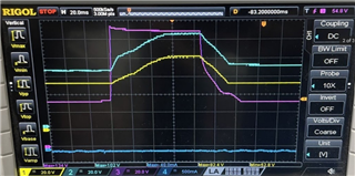

We are using BQ76952 in a 16S BMS. In the event of an Over-current during charge, the AFE turns OFF the charge FETs by command of the microcontroller based on charging current thresholds. After the FETs were open, we observed an increase of voltage on the pack+ pin to 95V, followed by an unintentional rise in AFE CHG pin voltage driving the charge FET gate. This leads to charge FETs operating in linear regions and hence getting damaged.
Signal definition:
  • Yellow: Charge FET gate w.r.t Ground(BAT-)
  • Light blue: BAT+
  • Purple: MATH function where it represents Charge FET gate to source voltage
  • Pink: Drain common to CHG and DSG FET w.r.t Ground(BAT-)
  • Dark Blue: Current where 1V represents 10A
Here is a snapshot where Charge FETs get damaged after shifting into a linear region

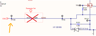

The Mosfet gate circuit followed in the above design is according to TIDA-010208.

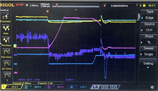

The following test was performed to deduce leakage in voltage from the AFE CHG pin by removing the current limiting resistor and measuring the voltage of the CHG pin.
Here, DSG FET and CHG FET were turned OFF, and the battery voltage was approximately 53V. On a surge of 135V on the PACK+, a voltage induced in the CHG pin and Charge pump was observed internal to AFE. This suspected rise in voltage could be the cause for charge FETs entering the linear region and, hence, the failure.
Signal definition:
  • Yellow: CHG pin w.r.t Ground(BAT-)
  • Light Blue: CP1 pin w.r.t Ground(BAT-) ( hidden behind yellow signal)

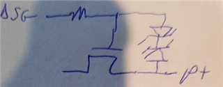

    • Ensure DSG does not see a voltage higher than CP1.
      • Voltage from PACK+ can leak to DSG if it is larger than the CP1 voltage. Sometimes adding back-to-back Zeners is enough if PACK+ is not going too much more above DSG, as seen below:

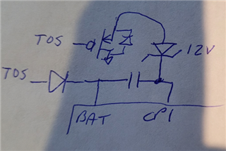

    • Clamp CP1 voltage to ensure it does not go above 20-V above BAT.
      • Zener + P-FET could work, something like seen below:
