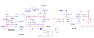

Hi, TI support team
My customer is developing for using BQ27220.
Then currently there are some problems.
1. Differences in detecting level of gauge IC depending on power source
There is a significant difference in the remaining capacity of the battery indicated by the gauge IC when the device is turned on with battery power and when turned on with USB power.
- This is the logarithm of the voltage (0x08, 0x09), remaining capacity (0x10, 0x11), and current current (0x0C, 0x0D) values indicated by the gauge IC when the device is turned on with battery power.
bq27220_update_status: 3548 mV, 86 mAh, 26 %, Current 11 mA
bq27220_update_status: 3547 mV, 86 mAh, 26 %, Current 11 mA
bq27220_update_status: 3546 mV, 86 mAh, 26 %, Current 11 mA
- This is the log when the device is turned off, turned on with USB power, and the above items are read.
bq27220_update_status: 3737 mV, 205 mAh, 62 %, Current 332 mA
bq27220_update_status: 3738 mV, 205 mAh, 62 %, Current 332 mA
bq27220_update_status: 3739 mV, 205 mAh, 62 %, Current 332 mA
bq27220_update_status: 3740 mV, 205 mAh, 62 %, Current 332 mA
bq27220_update_status: 3741 mV, 206 mAh, 62 %, Current 332 mA
bq27220_update_status: 3742 mV, 206 mAh, 62 %, Current 332 mA
- This is the log when you turn off the device again and turn it on with battery power.
bq27220_update_status: 3563 mV, 92 mAh, 28 %, Current 11 mA
bq27220_update_status: 3562 mV, 92 mAh, 28 %, Current 11 mA
bq27220_update_status: 3561 mV, 92 mAh, 28 %, Current 11 mA
bq27220_update_status: 3560 mV, 92 mAh, 28 %, Current 11 mA
2. Gauge reset
When you turn the device off and on, the register items listed below that were set and written in the data memory of the gauge IC are initialized. Hardware-wise, the gauge is directly connected to the battery.
0x929D  Full Charge Capacit    336 mAh
0x929D  Design Capacity    336 mAh
0x92A3  Design Voltage    3701 mV
Please refer to below circuit.
Thanks.
MJ
  • Hello MJ,
    Can you please provide me with your log files and the gg file for this?
    Jonny.
  • Hello Jonny,
    Thank you for inviting me to this topic.
    I am currently developing firmware for devices equipped with bq27220 gauge IC, and I have attached the log generated by the device.
    Currently, there are two ways to turn on the device: turning it on with battery power and turning it on by connecting USB power. What is strange is that the resistor values for the battery remaining capacity (0x10, 0x11) and state of charge (0x2C, 0x2D) are very different. To minimize factors that could affect the Gauge IC, no configuration settings were made and only periodic read values were output to the log in the default state.
    The testing procedure is as follows:
    1. Disconnect the battery to set the gauge IC to default.
    2. Connect the battery.
    3. Turn on the device on battery power.
    4. Wait a moment, and output the gauge values.
    5. Turn off the device.
    6. This time, connect the USB power cable to turn on the device.
    7. Wait a moment, and output the gauge values.
    8. Turn off the device.
    9. Now turn on the device using battery power.
    10. Wait a moment, and output the gauge values.

    For the GG file, should I solder wires to the I2C line of the device and connect them to the EV2400 and bqStudio?
    Yeongil
  • Hello Yeongil,
    Can you please provide me with the log and gg file given by bqStudio? In order to obtain the log using bqStudio, you need to press the "start log" button at the top right of the Registers tab (see image below).
    Additionally to obtain the gg file, you can export this by going to the "Data Memory" tab in bqStudio and clicking the "Export" button on the top right (please see the image below).
    Jonny.
  • Hello Jonny,
    Thanks for your kind explanation.
    We soldered the wires and a switch to the I2C lines of the device. Now we can switch the connection between the device and EV2400 and capture logs. I will update the log and gg file soon. Thank you.
    Yeongil
