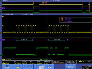

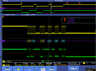

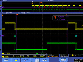

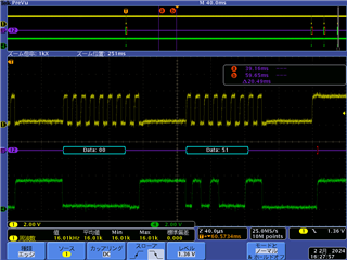

A product using BQ40Z80 was returned from the market as a communication defective product.
When I checked the communication waveform, the clock strech was abnormally long compared to the normal product.
I have attached the waveform, so please let me know what causes this.
The waveforms are SCL (yellow) and SDA (green) of the SMBus communicating with battery management studio.
                   nomal product
nomal product
           defect product
defect product

  • Hello.
    I add some information.
    All data can be read correctly but stop condition never appear until timeout of 25ms.
    The behavior w/PEC and w/o PEC seems the same.
    Only 0x16 0x44 0x02... command complete quickly.
    Why the device stretch the clock although all data was sent correctly?
    We would like to know the cause of this phenomenon, and how to return to normal operation.
    regards,
    Hiro.

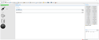

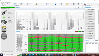

    Additional information.
    When I communicated the defective product with the Battery Management Studio and checked the bit registers, I found that EC2, EC1, and EC0 in the battery status were bit high.
    From the datasheet this is an unknown error.
    I'll attach a photo.
    Masashi.

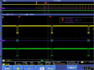

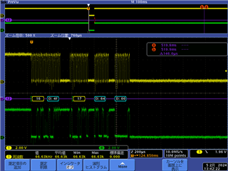

  • Anthony,
    Could you please let us know about the following?
    1. What is happening inside the device when "long stretch” occurs? What does “unknown errormean?
    2. I observed waveform of bus line and checked every commands of srec read.
    There was no “DeviceReset” command in that. Is that mean entering ROM mode is required to quit from the “unknown error”, or “DeviceReset ” command also effective?
    3. I would like to confirm if “DeviceReset ” command solve this issue. For that, I would like to reproduce long stretch. Can you suggest the way how to reproduce the long stretch, please?

  • Hi Musashi, Hiro,
    Will this kind of clock stretching occur when the EC2, EC1, and EC0 bits are high?
    Also, in what cases do the EC2, EC1, and EC0 bits go high?
    The EC2, EC1, and EC0 bits are to represent the error code of what is occurring within the communication. These bits will represent all high when the error with the SMBus communication is unknown to it's firmware, which could be caused by this long clock stretch. However, these bits should not have a direct effect on the communication and are just used for representation of the error. I believe that this long stretch is being caused by something keeping the host busy for an extended amount of time to the timeout:

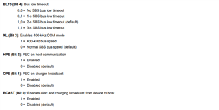

    If possible, please tell me how this register below is set on the device:

  • Hi Anthony,
    Our device setting of SBS Configuration is 0x80.

  • Hi Masashi,
    Thank you for clarifying. I wanted to confirm that you had clock stretching enabled on your device, which you do.
    Regarding how the customer is communicating with the gauge, are they using the EV2400 or a host device? If they are using their own host, are there other devices communicating on the same lines as the gauge?

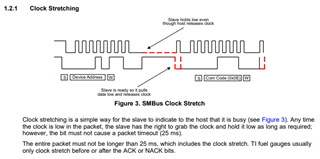

  • Hi Hiro,
    There are a couple issues that could be causing the long clock stretch, can you please confirm if the host MCU being used by the customer supports clock stretching? This is the most typical error when it comes to clock stretching.
    More information about clock stretching can be found in the document below:
    https://www.ti.com/lit/pdf/slua475
    Regarding how to return it to normal, I believe that the device reset should assist this issue in returning the device to normal.
