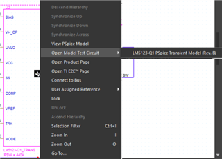

I am using PSPICE for TI and want to test the LM5123-Q1 PN. I can't find the test circuit of the Transient model (I downloaded the latest version,rev.B). Is it available or is planned to be in the near future?
Thank you

Hello Brigitte,
(P.N = Part number sorry for that). I want to test the LM5123-Q1 but I can only find the Average model in the PSPICE for TI. I can't find the Transient circuit model. I get this message while trying to open it:
Sergi Q
Hello Sergi Q,
Sorry that there is no transient model there. Please download it from the product folder LM5123-Q1 data sheet, product information and support | TI.com
In parallel, I will try to find out why it is not included in pSpice for TI.
Brigitte

Hi Brigitte,
I get the same error. But I was able to manually open by selecting open, and navigating to:
C:\cds_spb_home\cdssetup\pspTILibDir\ReferenceDesign
There, I decended into LM5123_Q1_TRANS_V4_0.
We'll look into why it isn't opening automaticaly. I suspect something in the metadata is corrupted or pointing at the wrong location.
