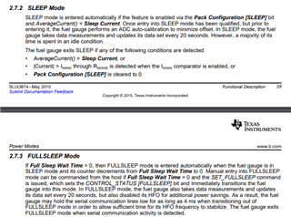

  • Hello Jay,
    In regards to our previous discussion, if you are using the BQ27546-G1, you will most likely want to use the gauge in one of the power saving modes (either SLEEP or FULLSLEEP mode, please see the image below). In these power modes, the gauge will take measurements less frequently (every 20 seconds) to conserve power.
    Additionally, if all you are wanting is the battery status and the remaining capacity from the battery, you can read out the SOC from the gauge and the Remaining Capacity from the gauge.
    Jonny.
