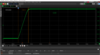

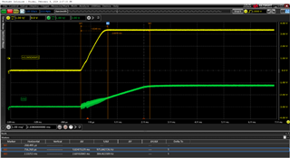

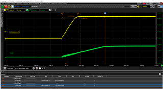

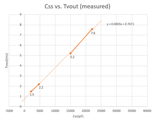

I designed 9.16 Slow Start (SS/TR) in the LMZ31506 data sheet with Css=4700pF (±10%) and SS time=2.8ms, but the power startup result is 2.2041ms. (See attached waveform)
Even taking into account the error of the capacitor, the result is outside the specified range.

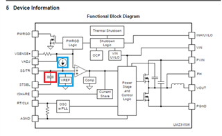

So, could you please tell me about the Soft-start charging current range of LMZ31506?
