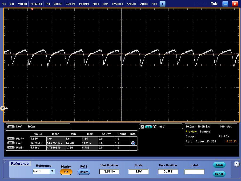

Working with PoE for the first time using the TPS23754 in a design that matches the -420EVM.  I got my first board spin in and although I did get 5v on my output which could easily handle a 2A load (all my system requires), the output was very noisy regardless of my load.  I had roughly 1.4v ripple at about 13kHz to the point where it is quite audible.  I chased the noise through the system and it basically exists everywhere as soon as I get into my RTN ground section.  I can however, cause the noise to vary and in some cases go away momentarily by bridging my RTN and digital grounds with my finger near the feedback section.

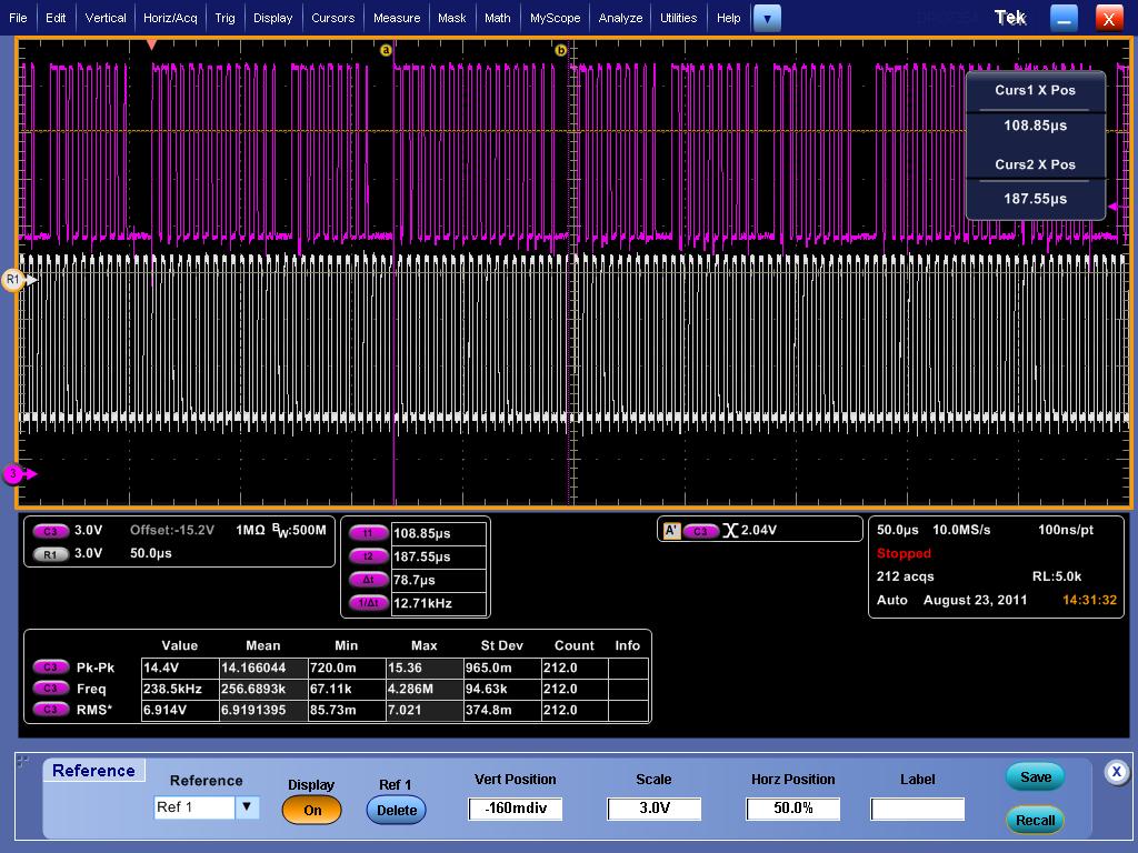

Any thoughts on areas that I can probe to find where the source of this noise could be coming from.  I actually see the 13kHz in a number of areas including on my Gate pin where normally on the EVM I see a 250kHz pulse train, on my board I see 250kHz pulses and then a long gap on the last pulse which repeats roughly every 13kHz (with some variation).  It's also on the input to my flyback transformer as well, not surprisingly.
In the meantime, I'll be double checking that my BOM matches that of the EVM.  I can post excerpts of the schematic and layout if that might be helpful.  Screen shots of the output signal and my gate pin are attached.

UUT Vout signal:
UUT Gate Signal (purple) compared to EVM Gate(white):
