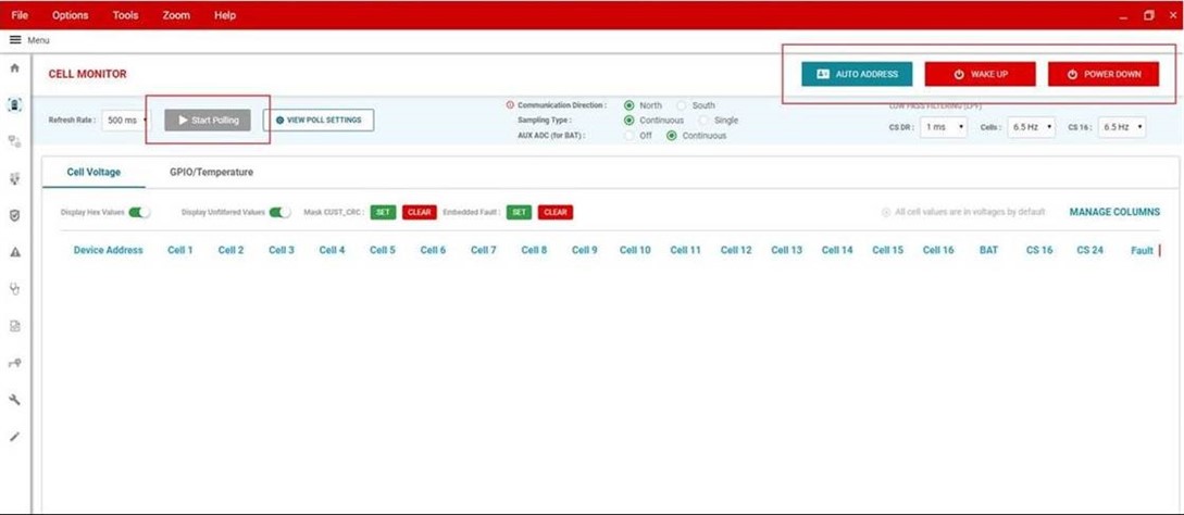

I want to design a BMS which use the BQ79656EVM-021, And by the USB TO any
when the system linked
the wake up is ok,but auto address freeze
please advise it,thanks
hi Sir

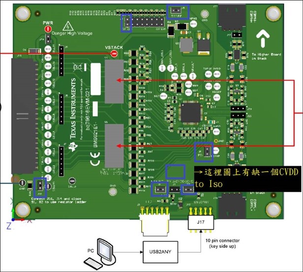

1. There is a hardware configuration issue on the EVM. Can you send a picture of the EVM? I will need to see the EVM version and jumper configuration.

3. There is some issue with the GUI we have not yet observed. Once we get the answer to 1 we can replicate this issue in the lab and determine the cause.

1.The picture is captured from user guide. The jumper location on BQ79656EVM is showed by “blue”.
2.
Plug and un-plug over 50times.
It is not USB2ANY malfunction issue.
There is one label on the EVM which is BQ79659EVM-021.
No other version of PCB is printed on PCB.
