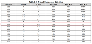

i'm using your example numbers for EQ 20 , LM76005 DS page 26 and getting that Cout > 1.4mF
Vin=24V
Vout=5V
Iout=5A
dVout=30mV
fsw=400kHz
D'=1-D=0.7916667
r=0.291
L=6.8uH

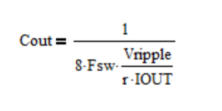

Is there an error in the equation? because when i use simplified equation for cout_min form SLVA477B EQ12
Coutmin=(diL)/(8*fsw*dVout) = 15uF
