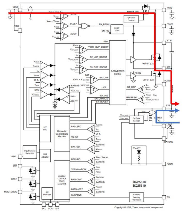

My customer has a question about overcurrent protection of BQ25619.
He understood from the datasheet that IINDPM can be used for overcurrent protection.
But he is concerned with BQ25619 behavior of Buck converter part when the load connected to the VSYS pin is shorted.
Besides IINDPM and VINDPM, is there any overcurrent detection in the buck converter part (HSFET(Q2) LSFET(Q3))?
What happens to BQ25619 if the load connected to the VSYS pin is shorted when DC power supply come from VBUS pin.
Your advice is appreciated.
