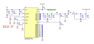

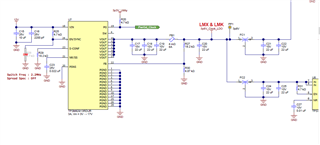

TPSM82913: schematic review, especially input & output capacitors
Part Number: TPSM82913
Hi team,
Could you review two schematic as below? Especially, could you review the input and output capacitors? There are concerns that capacitor value cosiderign DC-bias can't meet device recommendation.
Designator Quantity Value PartNumber Manufacturer
C15, C39 6 10 uF 08053D106KAT4A KYOCERA AVX
C16, C40 2 2200 pF 04023C222JAT2A KYOCERA AVX
C17, C18, C19,  C41, C42, C43 16 22 uF C2012X7S1A226M125AC TDK Corporation
