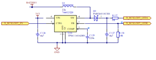

TPS61160A: Can this part run with VIN=3V3 and the inductor connected to a different higher supply
Part Number: TPS61160A
Can I use a TPS61160A as shown below, with Vin=3V3 and the inductor connected to a battery (3.4 to 12V)
I think it should be more efficient when the output is a low current (which mine in), because the Iq will come from my 3V3 supply:
3V3 connection: 1.8mA x 3.3V = 5.94mW with 10% conversion loss on the 3V3 = 6.5mW
Vin connected to battery: 1.8mA x 4V = 7.3mW with no conversion loss, getting worse when the battery is fuller
