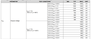

I have a question about the VDO listed on page 6, "5.5 Electrical Characteristics (continued)" of the datasheet.
1) The TEST CONDITION of the VDO lists the range of each Vout. Is it correct to understand that the VDO is fixed for each voltage of the output voltage fixing device?
ex) A device with Vout=0.9V (fix) will have a constant VDO of 1350mV (typ).
A device with Vout=3.3V (fix) will have a constant VDO of 300mV (typ).
Or does the VDO change step by step depending on the output voltage?

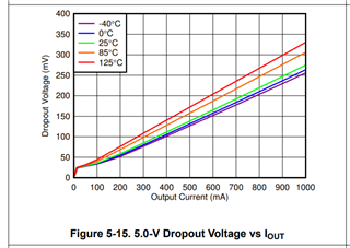

2) Figure 5-15 shows a 5.0 V graph. But there is not device have 5.0V output voltage(fix). What does this 5.0 V represent?
