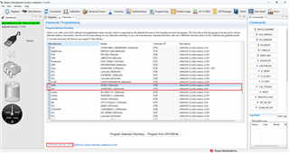

We got the chemical ID from your site. The chemical ID is 3731. But chemical id were not in the Battery Management Studio software. Please give me a solution.

Are you sure you updated the ChemID list correctly. I have the most recent ChemID version and ChemID 3731 is showing up.

Can you please check the box on the top that says "Include chemistry IDs that do not support Turbo Mode 2"
